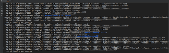

4.解决bes对web spring-socket兼容问题
启动过程中报错:
报错原因是因为bes的包对spring-websocket包兼容有问题,未依赖koca-websocket(里面有spring-websocket包)不会有该问题。

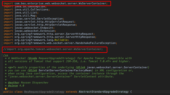

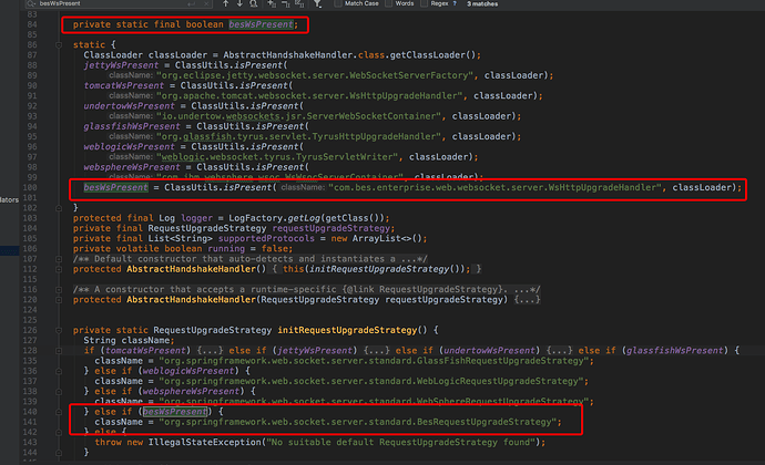

可以通过重写spring原生类来解决该问题,在最外层application中添加org.springframework.web.socket.server.support.AbstractHandshakeHandler类和org.springframework.web.socket.server.standard.BesRequestUpgradeStrategy类来覆盖spring-websocket中的原生类,使原生类失效而添加的类生效,添加类代码结构如下:
修改的AbstractHandshakeHandler类,改动点如下:
新增的BesRequestUpgradeStrategy类,该类代码拷贝自TomcatRequestUpgradeStrategy类,修改点如下:

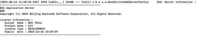

5. 服务正常启动
启动过程会输出如下内容:

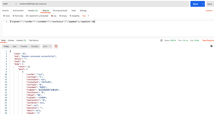

如下调用普通api正常:
调用actuator接口正常:

类1:
 * Copyright 2002-2017 the original author or authors.
 * Licensed under the Apache License, Version 2.0 (the "License");
 * you may not use this file except in compliance with the License.
 * You may obtain a copy of the License at
 *      https://www.apache.org/licenses/LICENSE-2.0
 * Unless required by applicable law or agreed to in writing, software
 * distributed under the License is distributed on an "AS IS" BASIS,
 * WITHOUT WARRANTIES OR CONDITIONS OF ANY KIND, either express or implied.
 * See the License for the specific language governing permissions and
 * limitations under the License.
package org.springframework.web.socket.server.standard;
import com.bes.enterprise.web.websocket.server.WsServerContainer;
import java.io.IOException;
import java.util.Collections;
import java.util.List;
import java.util.Map;
import javax.servlet.ServletException;
import javax.servlet.http.HttpServletRequest;
import javax.servlet.http.HttpServletResponse;
import javax.websocket.Endpoint;
import javax.websocket.Extension;
import org.springframework.http.server.ServerHttpRequest;
import org.springframework.http.server.ServerHttpResponse;
import org.springframework.lang.Nullable;
import org.springframework.web.socket.server.HandshakeFailureException;
//import org.apache.tomcat.websocket.server.WsServerContainer;
 * A WebSocket {@code RequestUpgradeStrategy} for Apache Tomcat. Compatible with
 * all versions of Tomcat that support JSR-356, i.e. Tomcat 7.0.47+ and higher.
 * <p>To modify properties of the underlying {@link javax.websocket.server.ServerContainer}
 * you can use {@link ServletServerContainerFactoryBean} in XML configuration or,
 * when using Java configuration, access the container instance through the
 * "javax.websocket.server.ServerContainer" ServletContext attribute.
 * @author Rossen Stoyanchev
 * @since 4.0
public class BesRequestUpgradeStrategy extends AbstractStandardUpgradeStrategy {
  @Override
  public String[] getSupportedVersions() {
    return new String[]{"13"};
  @Override
  public void upgradeInternal(ServerHttpRequest request, ServerHttpResponse response,
      @Nullable String selectedProtocol, List<Extension> selectedExtensions, Endpoint endpoint)
      throws HandshakeFailureException {
    HttpServletRequest servletRequest = getHttpServletRequest(request);
    HttpServletResponse servletResponse = getHttpServletResponse(response);
    StringBuffer requestUrl = servletRequest.getRequestURL();
    String path = servletRequest.getRequestURI();  // shouldn't matter
    Map<String, String> pathParams = Collections.<String, String>emptyMap();
    ServerEndpointRegistration endpointConfig = new ServerEndpointRegistration(path, endpoint);
    endpointConfig.setSubprotocols(Collections.singletonList(selectedProtocol));
    endpointConfig.setExtensions(selectedExtensions);
    try {
      getContainer(servletRequest).doUpgrade(servletRequest, servletResponse, endpointConfig, pathParams);
    } catch (ServletException ex) {
      throw new HandshakeFailureException(
          "Servlet request failed to upgrade to WebSocket: " + requestUrl, ex);
    } catch (IOException ex) {
          "Response update failed during upgrade to WebSocket: " + requestUrl, ex);
  @Override
  public WsServerContainer getContainer(HttpServletRequest request) {
    return (WsServerContainer) super.getContainer(request);
类2:
 * Copyright 2002-2019 the original author or authors.
package org.springframework.web.socket.server.support;
import java.nio.charset.StandardCharsets;
import java.security.Principal;
import java.util.ArrayList;
import java.util.Arrays;
import org.apache.commons.logging.Log;
import org.apache.commons.logging.LogFactory;
import org.springframework.context.Lifecycle;
import org.springframework.http.HttpMethod;
import org.springframework.http.HttpStatus;
import org.springframework.util.Assert;
import org.springframework.util.ClassUtils;
import org.springframework.util.ReflectionUtils;
import org.springframework.util.StringUtils;
import org.springframework.web.socket.SubProtocolCapable;
import org.springframework.web.socket.WebSocketExtension;
import org.springframework.web.socket.WebSocketHandler;
import org.springframework.web.socket.WebSocketHttpHeaders;
import org.springframework.web.socket.handler.WebSocketHandlerDecorator;
import org.springframework.web.socket.server.HandshakeHandler;
import org.springframework.web.socket.server.RequestUpgradeStrategy;
 * A base class for {@link HandshakeHandler} implementations, independent from the Servlet API.
 * <p>Performs initial validation of the WebSocket handshake request - possibly rejecting it
 * through the appropriate HTTP status code - while also allowing its subclasses to override
 * various parts of the negotiation process (e.g. origin validation, sub-protocol negotiation,
 * extensions negotiation, etc).
 * <p>If the negotiation succeeds, the actual upgrade is delegated to a server-specific
 * {@link org.springframework.web.socket.server.RequestUpgradeStrategy}, which will update
 * the response as necessary and initialize the WebSocket. Currently supported servers are
 * Jetty 9.0-9.3, Tomcat 7.0.47+ and 8.x, Undertow 1.0-1.3, GlassFish 4.1+, WebLogic 12.1.3+.
 * @author Juergen Hoeller
 * @since 4.2
 * @see org.springframework.web.socket.server.jetty.JettyRequestUpgradeStrategy
 * @see org.springframework.web.socket.server.standard.TomcatRequestUpgradeStrategy
 * @see org.springframework.web.socket.server.standard.UndertowRequestUpgradeStrategy
 * @see org.springframework.web.socket.server.standard.GlassFishRequestUpgradeStrategy
 * @see org.springframework.web.socket.server.standard.WebLogicRequestUpgradeStrategy
public abstract class AbstractHandshakeHandler implements HandshakeHandler, Lifecycle {
  private static final boolean jettyWsPresent;
  private static final boolean tomcatWsPresent;
  private static final boolean undertowWsPresent;
  private static final boolean glassfishWsPresent;
  private static final boolean weblogicWsPresent;
  private static final boolean websphereWsPresent;
  private static final boolean besWsPresent;
  static {
    ClassLoader classLoader = AbstractHandshakeHandler.class.getClassLoader();
    jettyWsPresent = ClassUtils.isPresent(
        "org.eclipse.jetty.websocket.server.WebSocketServerFactory", classLoader);
    tomcatWsPresent = ClassUtils.isPresent(
        "org.apache.tomcat.websocket.server.WsHttpUpgradeHandler", classLoader);
    undertowWsPresent = ClassUtils.isPresent(
        "io.undertow.websockets.jsr.ServerWebSocketContainer", classLoader);
    glassfishWsPresent = ClassUtils.isPresent(
        "org.glassfish.tyrus.servlet.TyrusHttpUpgradeHandler", classLoader);
    weblogicWsPresent = ClassUtils.isPresent(
        "weblogic.websocket.tyrus.TyrusServletWriter", classLoader);
    websphereWsPresent = ClassUtils.isPresent(
        "com.ibm.websphere.wsoc.WsWsocServerContainer", classLoader);
    besWsPresent = ClassUtils.isPresent("com.bes.enterprise.web.websocket.server.WsHttpUpgradeHandler", classLoader);
  protected final Log logger = LogFactory.getLog(getClass());
  private final RequestUpgradeStrategy requestUpgradeStrategy;
  private final List<String> supportedProtocols = new ArrayList<>();
  private volatile boolean running = false;
   * Default constructor that auto-detects and instantiates a
   * {@link RequestUpgradeStrategy} suitable for the runtime container.
   * @throws IllegalStateException if no {@link RequestUpgradeStrategy} can be found.
  protected AbstractHandshakeHandler() {
    this(initRequestUpgradeStrategy());
   * A constructor that accepts a runtime-specific {@link RequestUpgradeStrategy}.
   * @param requestUpgradeStrategy the upgrade strategy to use
  protected AbstractHandshakeHandler(RequestUpgradeStrategy requestUpgradeStrategy) {
    Assert.notNull(requestUpgradeStrategy, "RequestUpgradeStrategy must not be null");
    this.requestUpgradeStrategy = requestUpgradeStrategy;
  private static RequestUpgradeStrategy initRequestUpgradeStrategy() {
    String className;
    if (tomcatWsPresent) {
      className = "org.springframework.web.socket.server.standard.TomcatRequestUpgradeStrategy";
    } else if (jettyWsPresent) {
      className = "org.springframework.web.socket.server.jetty.JettyRequestUpgradeStrategy";
    } else if (undertowWsPresent) {
      className = "org.springframework.web.socket.server.standard.UndertowRequestUpgradeStrategy";
    } else if (glassfishWsPresent) {
      className = "org.springframework.web.socket.server.standard.GlassFishRequestUpgradeStrategy";
    } else if (weblogicWsPresent) {
      className = "org.springframework.web.socket.server.standard.WebLogicRequestUpgradeStrategy";
    } else if (websphereWsPresent) {
      className = "org.springframework.web.socket.server.standard.WebSphereRequestUpgradeStrategy";
    } else if (besWsPresent) {
      className = "org.springframework.web.socket.server.standard.BesRequestUpgradeStrategy";
    } else {
      throw new IllegalStateException("No suitable default RequestUpgradeStrategy found");
    try {
      Class<?> clazz = ClassUtils.forName(className, AbstractHandshakeHandler.class.getClassLoader());
      return (RequestUpgradeStrategy) ReflectionUtils.accessibleConstructor(clazz).newInstance();
    } catch (Exception ex) {
          "Failed to instantiate RequestUpgradeStrategy: " + className, ex);

注意此处跟spring-websocket版本无关系。
特别注意,由于KOCA 3.x版本升级spring boot 到2.5.x,与bex 9.5.2不兼容;使用KOCA 3.x及以上版本时,需要升级 bes 版本到9.5.5.x
